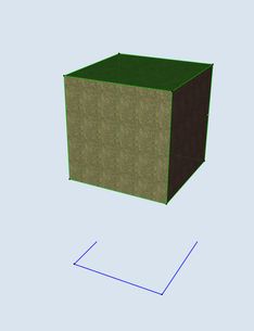

I prefer using real RL's for floor levels (as recommended by Graphisoft) and am modelling a house on a steeply sloping site with ground level about 180m above sea level. External 3D models therefore default with 180m high columns of earth under the ground floor. Just as well I am not building on top of Mt Everest!
I can avoid this by modelling with nominal levels - say ground floor at 5m (to allow for the slope). Archicad examples conveniently model their examples on flat, or nearly flat, sites floating near sea level which entirely avoids this issue. Is there a way to use real RL's on high sites without generating this problem?

Thanks David. I don't have the same Mesh picture as you. No 'Bottom and Top', no 'Mesh Skirt Height (T)'. I try to show a picture of what I have.

Lingwisyer
Guru
Mesh Skirt Height being the distance down from the Mesh Reference Plane to the bottom of the mesh is the 1000 in your image.
You might be able to put something like -175000 as your value for it to offset it upwards above the Mesh Reference Plane given your terrain difference is less that 12.5m.

I had a look at this again and what I said won't help you in your case.
Because you seem to be modelling your building at 0 (zero) floor level, and are setting your mesh reference line down at sea level (1187440) and then setting the heights of the top points to their true height above sea level (hence the tall mesh), you won't be able to control the skirt height as I suggested.
You can make it deeper (adjust the figure (860 shown here) or drag the base with the pet palette - height option.
But it can only be moved up to the reference line (zero skirt height) - it can't have a negative value to reduce the height of the mesh above the reference plane.
The only way to hide this height is to limit section and elevation heights and to use a cutting plane in 3D as mentioned before.
Otherwise, set the mesh reference line to 0 (zero) but this will lift the entire mesh up higher.
Then you will have to adjust the height of every top node down by 187440 in your case.
This can be done in 3D with the pet palette with 'Z' height option.
Drag each node down and type ... 187440 ENTER.

Actually you can if you type the figure in the mesh settings (info box).
It seems you can't drag the base in 3D above the reference plane which is what I was trying.
So, @KeesW , if you type a figure like this in your mesh settings, it should look a lot shorter.
