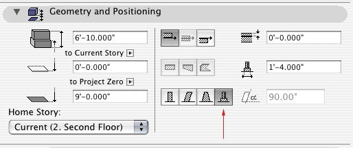

where is complex profile in the wall tool?
David Maudlin
Rockstar
Here.
