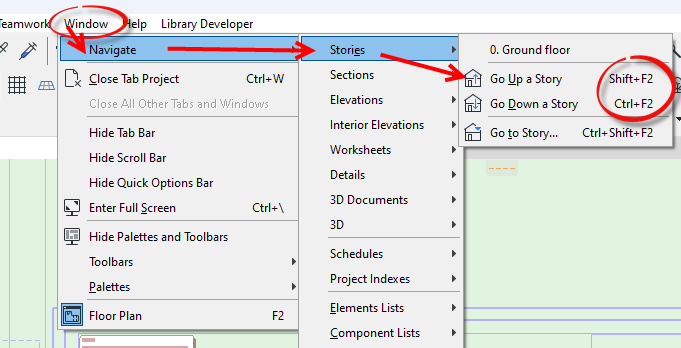

In AC22 my keyboard short cuts to go up and down stories was shift/F2 and Cntrl/F2
I can't find any control to go up and down stories
thanks
dean
Operating system used: Windows orig
a week ago
Go to the Work Environment > Keyboard Shortcuts to find or set the shortcut.
Or have a look in the menus to see what shortcut is set.
