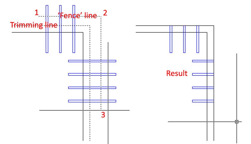

A really useful function that I miss from AutoCAD is a fence (polyline) setting for trimming multiple objects in one go.
At the moment as you rightly say, you can only trim elements one at a time. In certain circumstances drawing a multi-segmented line across several elements to be trimmed at once is much faster. They wouldn't necessarily even have to be in a straight line.
The Split tool almost works like this but you can only do a single straight segment in one go.

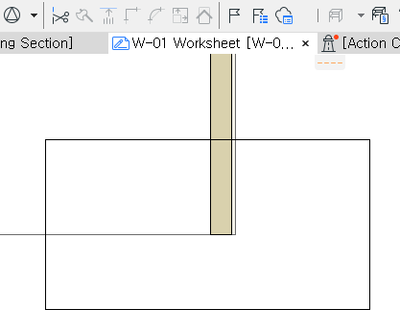

Are you saying that multi trim is possible?
If possible, may I ask for an explanation that a beginner can understand?
AC27 on window 11
