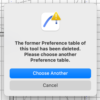

I can't use the pipes in mep, why.......
What can I do, please help.

you can try going to options - project preferences - route preferences and either:
1. reimport your tables from a different project
2. create new ones and use those.

This will probably be connected to updating Archicad.
I think that in Update 1 of AC28 there was added a possibiltity to set preferences also for reductions.
Go to the settings of pipes to the reduction part and in lower part select one of predefined. (I'm currently using CZE so "CHYBĚJÍCÍ" means "MISSING" 😉 )
