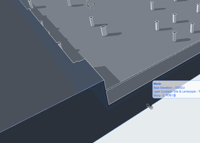

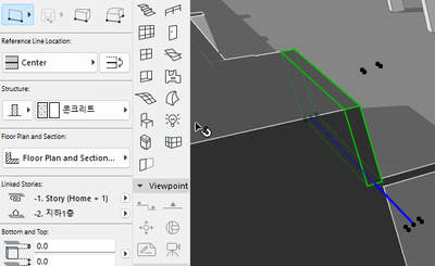

I want to make the color of the wall of the section and the site different.
What should I do?

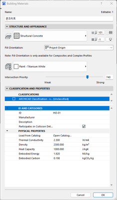

I changed the surface to white, but nothing happens.

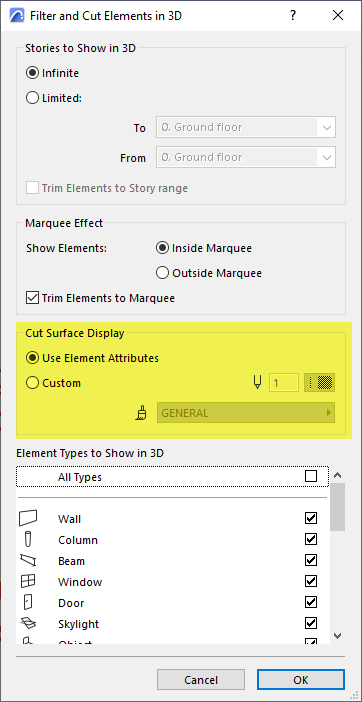

Check the Filter & Cut Elements in 3D settings.
You probably have 'Cute Surface Display' set to 'Custom' so all cut surfaces look the same.
