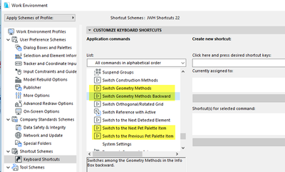

I would like to know about the SWITCH GEOMETRY METHODS (global) key other than the G key.
What to look for?
I'm looking for a key that goes back again, not the G key.
And I'm looking for the part that explains this key.
There is nothing in the shortcuts.
What should I search for?
AC27 on window 11
1 Solution
Actually there is a 'Geometry Backwards' command (I didn't look very closely).
It is just not assigned to a shortcut by default.
Go to post
3 Replies 3
It is simply a keyboard shortcut that cycles through the available geometry methods for any tool.
It only cycles one way in a continuous loop.
The command is 'Switch Geometry Methods'
