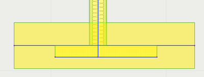

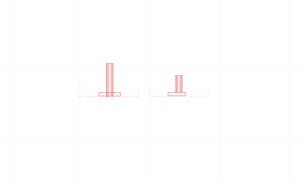

I'm running into a strange wall intersection issue and hoping someone can point me in the right direction.
I have three walls intersecting at two different locations:
Wall A (Concrete): 0 cm to 13.5 cm high (thinner than the other two)
Wall B (Plastic): 19 cm to 241 cm high
Wall C (Drywall): 0 cm to 316 cm high
At one intersection, everything works as expected – the drywall stops cleanly at the plastic wall.
However, at the other intersection, the drywall ignores the plastic wall and continues through to connect with the Concrete wall instead.
Both intersections involve the exact same three wall types and heights, yet they behave completely differently.
What I've already checked:
All walls have the same renovation status.
Building Material Priorities are the same.
"Use legacy intersection method" is disabled.
Has anyone seen this kind of inconsistent behavior? Are there specific settings or commands I should look at to force the drywall to consistently stop at the plastic wall?
Any advice would be greatly appreciated.
Thanks in advance!

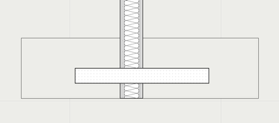

Friday
Without "Clean Wall Intersections" being on the screenshots are not really that much informative.
Friday
It is strange that the reference lines are correct.
It could be the junction order as Ling suggests.
I am suspecting a wall in a hidden layer maybe?

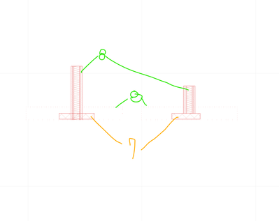

Hi Runxel,
Here you have the connection without Clean Wall Intersections:

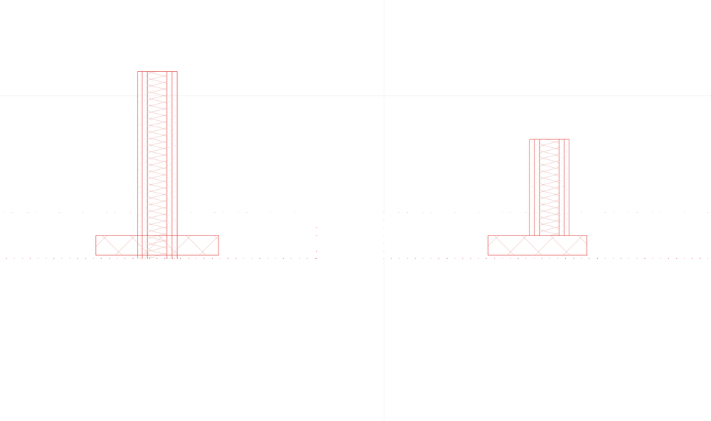

Monday
This is the junction order:
and this is the screenshot with displaying all layers, and both intersections are isolated in a different place in the model:

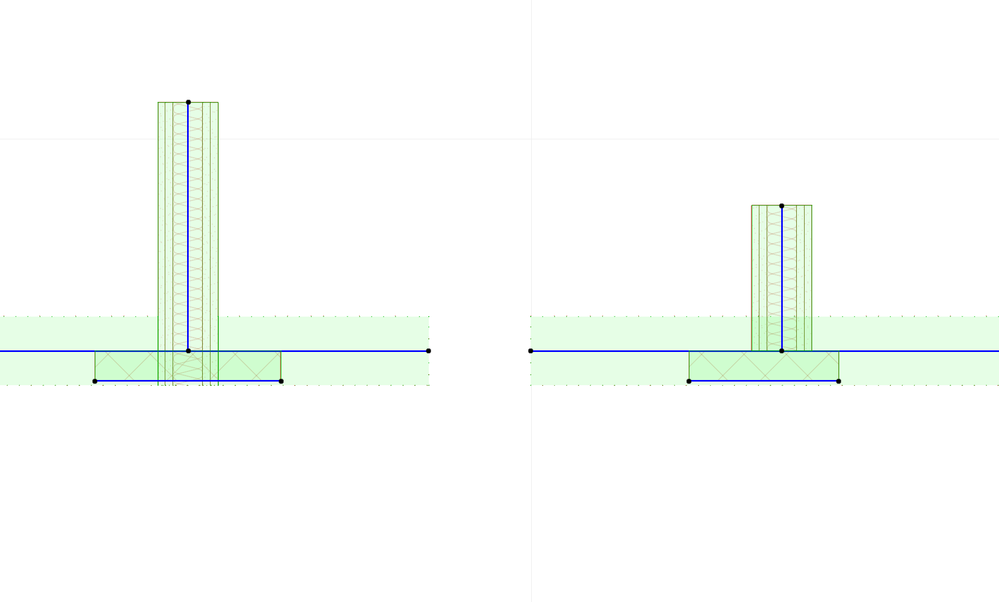

Monday
Thanks, @Heftor.

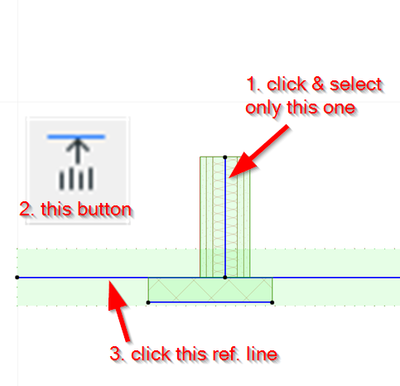

Since the reference lines of the drywall and the small wall on top of the concrete wall are not touching each other, the small wall can not contribute to the intersection. Why you happen to manage it in one case: I don't know, I can't. In my test it always look like this
However if I prolong the drywall's ref line so the meet up:
Then it looks just fine.
6 hours ago
Maybe some inaccuracy?
@Heftor would you mind following my 'precise' instructions?
