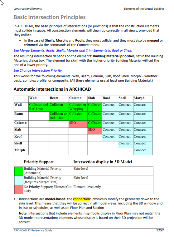

Automatic intersection only work between specific element types as shown below.
It doesn't mention meshes because they don't automatically intersect with anything.
