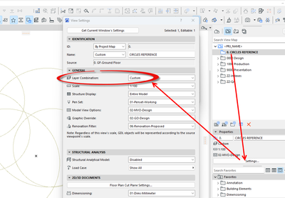

Can someone check this pls so I can understand if it's something on my end or if it's some kind of bug, or expected behaviour.
The attached file is very simple - just some intersecting circles on a hidden layer and shown as Trace Reference
With the TR active (circles layer TR), use the magic wand tool to create fills or a slab in one of the sections created by the intersecting circles
On my machine the Layer button on the Info Box starts flashing for a while, then the Magic Wand pre highlight appears and finally the fill appears, but there's a few seconds lag.
Is it working smoothly with you?

Your view for circles reference has a 'Custom' layer set.
You should never use any settings that says 'Custom'.
Change that to a layer combination that shows the circles.
Now try and it should be better.
There will still be a lag because it needs to find the circles in the trace reference.
If you simply turn the circles layer on in the main plans (and turn the trace off) it will be instant.

Thanks for taking the time to try this.
I wasn't aware of the "no custom" anything so will keep this in mind in future.
I made a layer combo for just the circles but I don't think it makes much difference. Still lots of flickering and lag.
Does the 'Layers' button on the Info Box start flickering when you use the magic wand tool (with TR on)?
I get that there is no delay when TR is off. I have several issues like this when using TR so I'm trying to understand if it's performance related or if it's a bug.

Yes I had the flickering of the layer name as well when the view was set to custom layers.
As soon as I set it to a layer combination that had the layer for the circles turned on flicker went away.
But there is still a lag for the fills to appear.
That is just because you are using a trace reference of a view that is using different settings to the plan view point you are placing the fills in.
Trace has always slowed Archicad down as it has to think about 2 different view settings at the same time.
Only turn it on when you need it.

OK I made layer combinations for both the reference layer on its own, and for the 2d view without the circles, and now I think it's working per your comments - no more flickering and shorter lag using the magic wand tool.
I tried this on a more complex scene with my usual workflow using an image file as my background (Trace Reference) and although I don't want to cry victory just yet, I think making sure there are layer combinations for all views (not 'Custom') makes a big difference to performance.
I'll report back once I've tested it a bit more but so far so good - thank you
