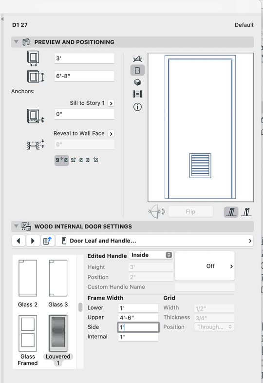

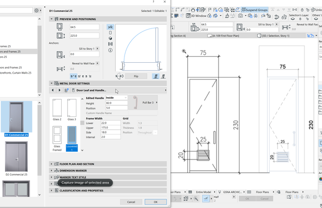

But we can already do that with the D1 Door included in the Library.   You will need to make a Custom Handle for the door - but this is the door you can use to get what you are asking for.  It's not the usual way to size a door.  Typically the door is sized per the door panel size - not the outside of the frame size.  Also, the size of the louvers may differ from one manufacturer to another.
You can add what ever Annotation you want to a Door Legend.

In the US library, this door has these options. Check your local library.
David

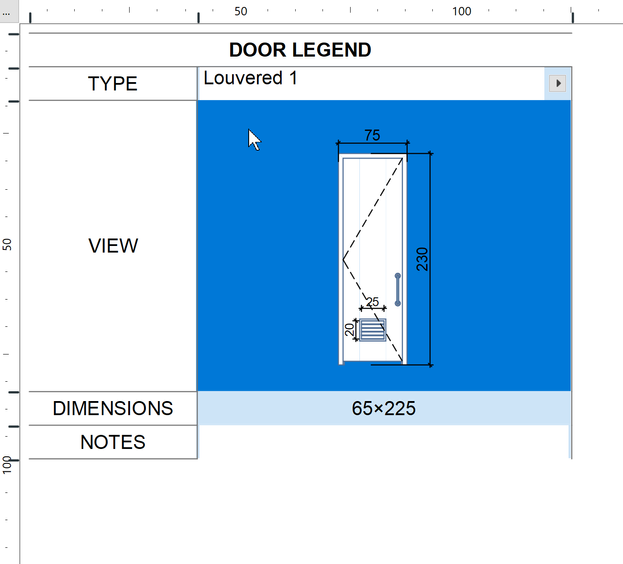

What do you need to display in Interactive Schedules?
Do you need a Door Library Part that has a vent that you can change to whatever size you want? Or is it a door that would always have a vent the same size in it ?
