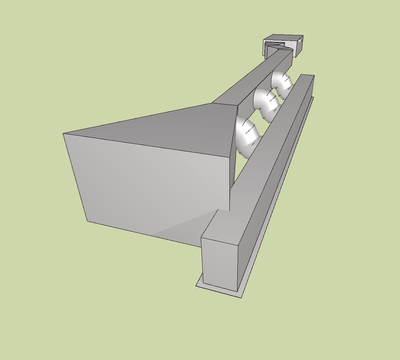

Section-related representation and modelling improvements: I am afraid there are still issues. Some MEP library parts are not showing at all.
MEP LIBRARY PARTS NOT SHOWING IN SECTIONS
Flexible duct-related improvements: Still it needs a lot of effort to make a Flexible duct to connect between two elements that are in different elevations.
Also I would expect that the Duct End Cap 27 would adjust its cross-section dimensions automatically to the dimensions of the duct you want to fit it into. It's an assumption I make since there is no available field where to type them. Is there something I am missing?

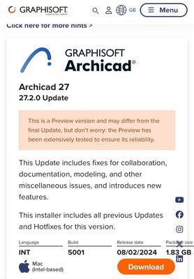

2024-02-17 09:20 PM
The MEP improvements are mostly from update 27.2 which is a preview version but is available for testing.

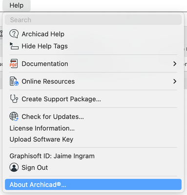

I am trying to figure out which version I am runing. I downloaded and installed version 27.2.0 BUT when I hit License information it says 27.0.0 Build number 5001. If I hit Check for updates it says up-to-date.

Check the build number under About Archicad...

Thnx. It says 5001 INT FULL
It is supposed to be the unique Build number of 27.2.0, right?
2024-02-22 09:07 PM
Yes, 5001 is 27.2.0
