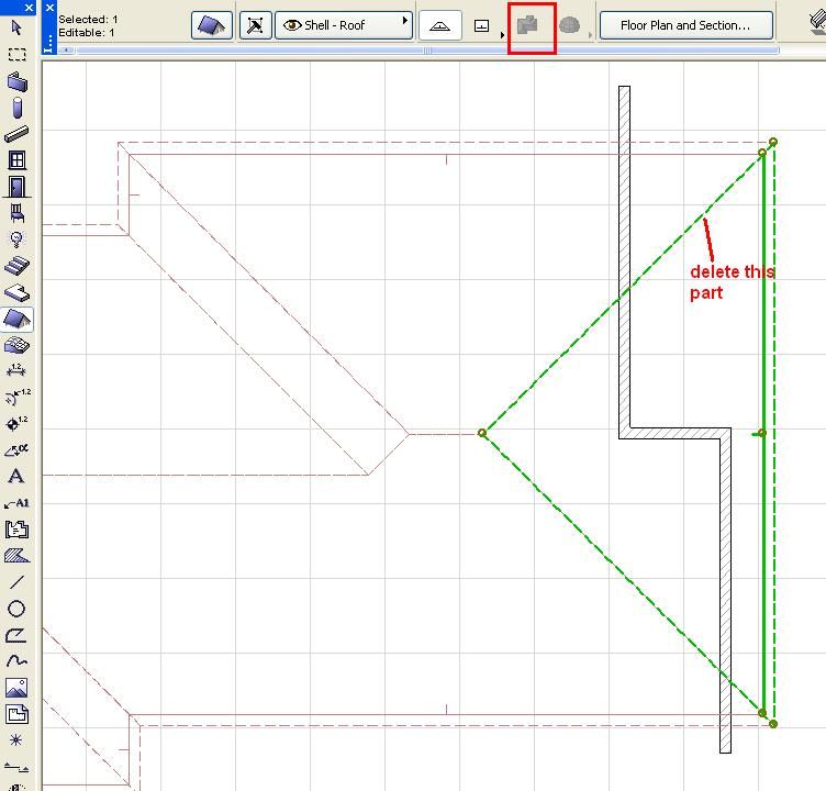

I would like for the roof to die in the wall on the second floor. Perhaps my problem was that I didn't model the walls. (I only model the roof, because that is all that I need)

For problem 1 and 2
Use poly roof in archicad and delete one part of the roof and modify the others by using pet palette (move node, ofset edge..)
see the jpegs
Pet palatte-modify jpeg
pardom my ignorance.. but how do I delete that piece??
also, I'm looking for pet pallet... but it doesn't show at windows/ pallets
Select the roof, then
Edit-grouping --suspend group (pull down menu) then delete the part.
To see the pet palette , select the part (roof,wall.etc) then click again.
