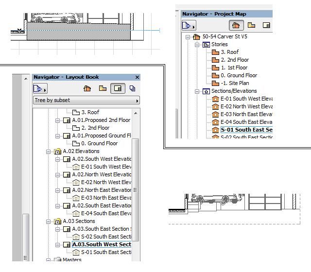

I recently started to use archicad (2-3 weeks ago) and i've run into a few problems that i've been able to fix but i've finally run into some thing i've not been able to sort out.
What is happening is that when i use the navigator and look up a section in the project map it shows the cut though of a mesh. But when i use that section in the layout book the mesh cut thoughs aren't visible.
If any one could help me with this i would be very grateful as i've been trying to google it all day with no success!!

There could be a number of reasons for this, but the first one I would check is that your VIEW has the mesh turned on.
I notice that you navigate to your section using the PROJECT MAP, but the Layout links via a VIEW MAP...which can have different layers on/off.

Many thanks, that was indeed my problem. The sections were set to a different layer combination to the elevations i was using which was also confusing me.
All fixed now tho
