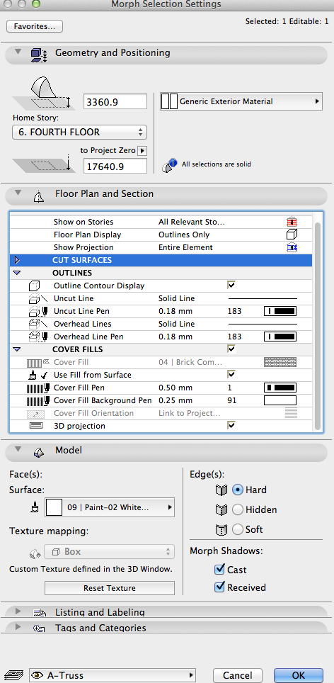

I have modeled a morph and am trying to get it to display in a 3D document which is essentially a hidden line axonometric view. For some reason, I cannot get it to appear in the view. I've attached a screenshot of it's properties. I have made sure that it's on the correct layer and renovation. Thanks!

I would first refer you to the post here: http://archicad-talk.graphisoft.com/viewtopic.php?p=235941#235941
As discussed in that post it could be many things but I would first look at the Renovation Filter, Layer Combination and Partial Structure Display settings for the View.
