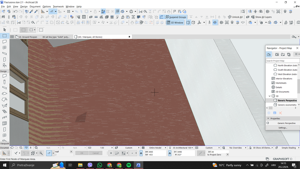

Hi again,
Can you help me understand why I can't see my tiles in 3D normally ? When I use camera it's ok but in 3D is like on a photo attached.
Thanks

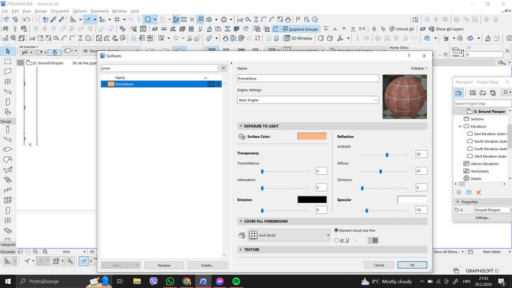

Difficult to understand what we are looking at...  could you place the material on a floor and show the material settings?

DaniBaiana
@cuba sure, sorry.

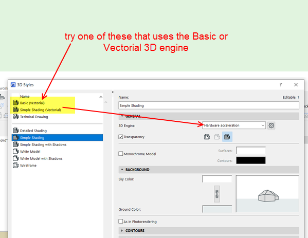

@DaniBaiana ,
In your 3D window, go to 3D Styles and switch to the Basic Engine.
Is that any better?
If so it might be an issue with your video drivers.
I would try to update them.
Also what type of video card do you have and are you working on a laptop?

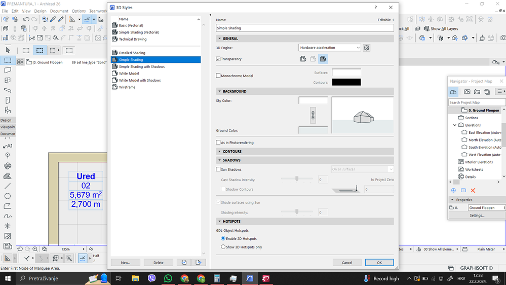

DaniBaiana
Hi Barry,
sorry for bothering but is that here? Pic in attach.
Yes.
Try one of the 'Vectorial'  styles.
Just to see if that shows any differently - trying to see if there is a problem with the 'Hardware Accelerated' engine (your video card).
