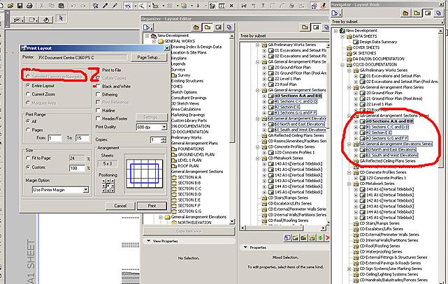

2. This problem is related to UI clarity
It is impossible to print 'selected layouts in the navigator' when the organizer is on... I reckon it should be addressed for the sake of consistency:
a. disable the navigator when the organizer is on (virtually replacing the navigator with organizer) or
b. enable printing from the organizer as for the navigator
attached jpg for illustration
