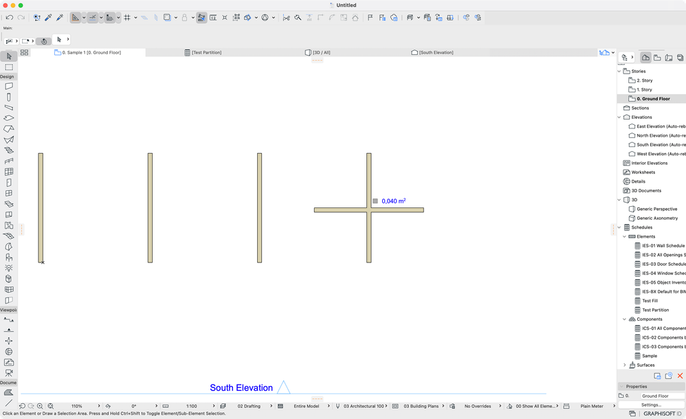

‎2021-09-21 05:24 PM - edited ‎2021-09-21 05:24 PM
Hi Vinicius,
Sure, I tried to be as descriptive as possible but I guess the image helps. See attached below:
On the left you have the modelled partitions and on the right I have measured with red hatches what we are trying to list: the "partition plan area" (a projection of the area occupied but the walls).
On the schedule at the bottom you can see the results for the property "area" and for our custom property as described in my first message.
Thanks again!

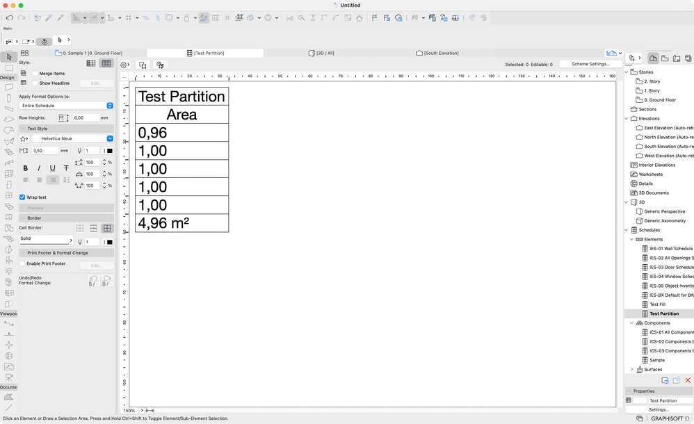

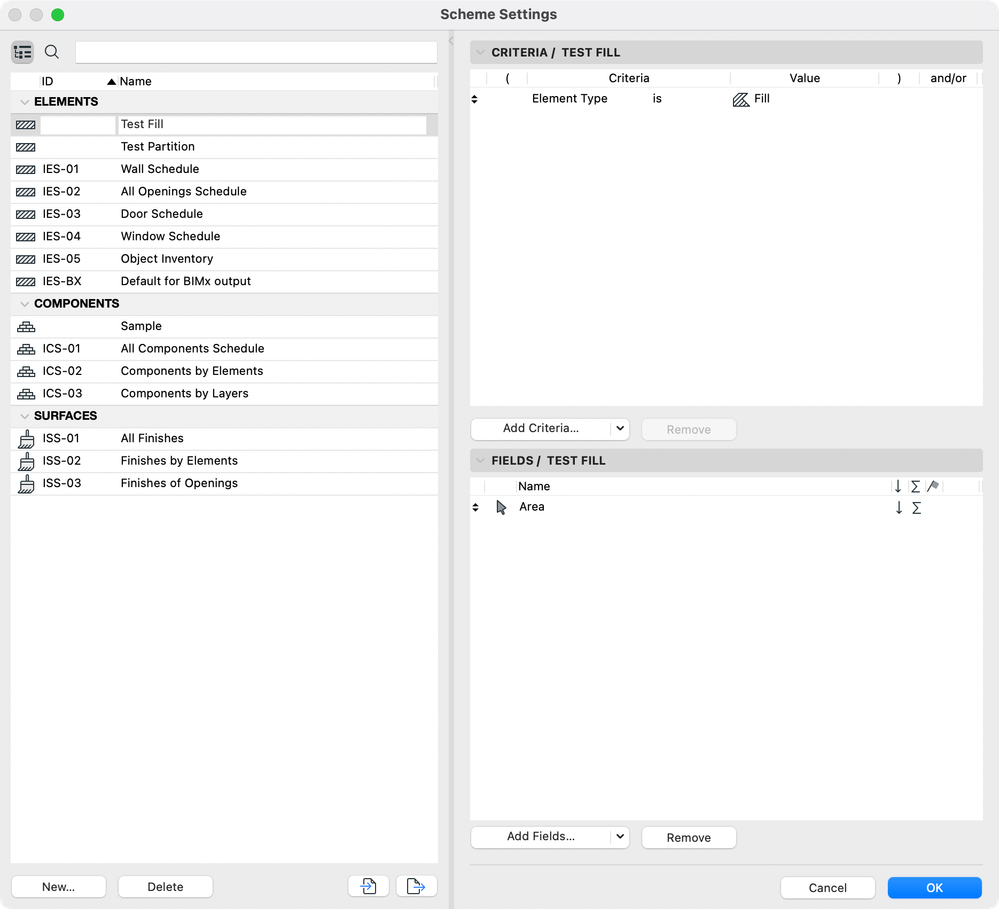

‎2021-09-21 05:48 PM
Thanks, @Carlos Schwarz, I got your point 😉
I found the correct results using the "Area" parameter in the schedule settings, as you can see in the images.
To double-check it, I created another fill schedule.
Could your share your schedule setting, so we can compare it?

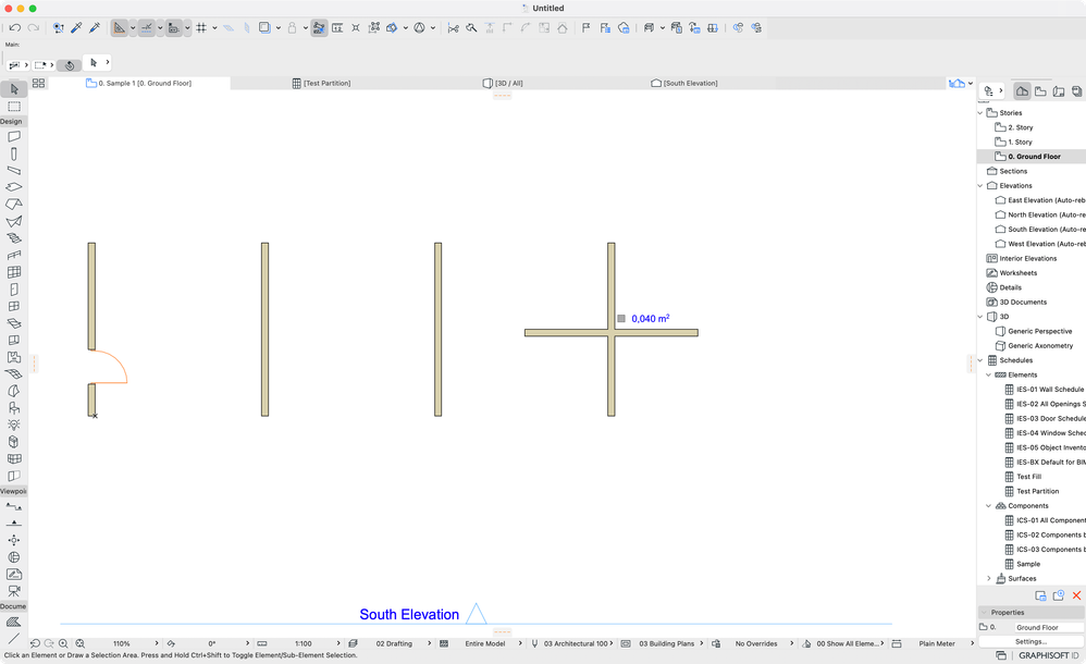

‎2021-09-21 07:26 PM
@Carlos Schwarz I double-checked, and that's what I found:
I made 5 walls, 5 x 0,20 m each, then I've 5 m2 in total.
I intersected 2 walls, and it was reduced 0,4 m2, that was correct.
3 different doors were placed and the result was still the same, what seems to fit your expectation, right?
You can share the .pla file here, via WeTransfer link, so I can check it out.
