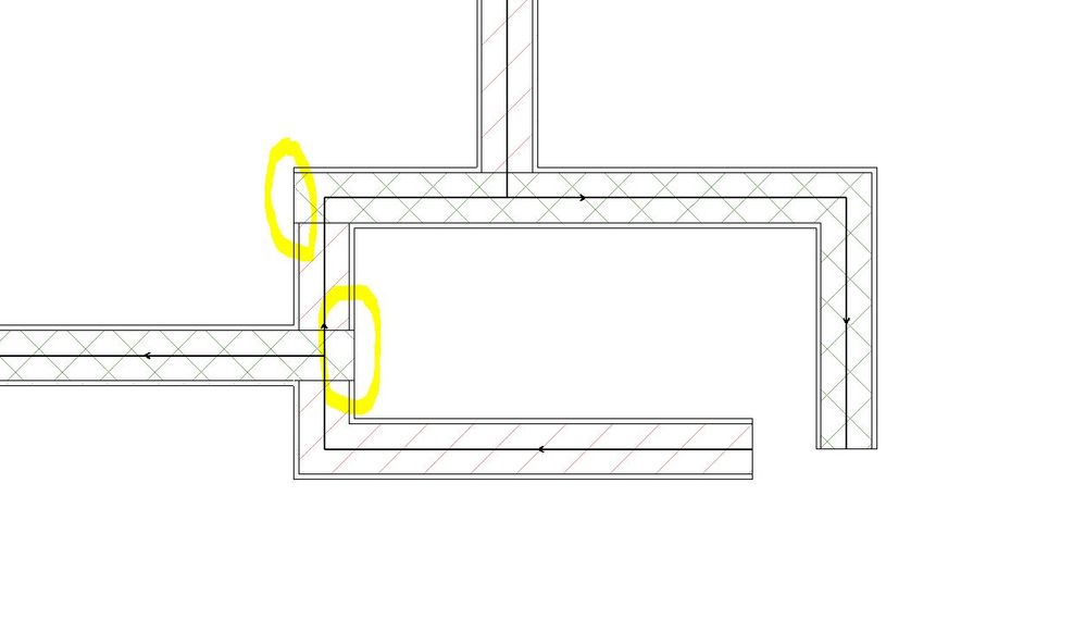

I need help with priorities in materials.
There are two basic types of wall:
- Brick wall with plaster
- Concerete wall with plaster
Of course plaster is something that should be around all wall perimeters after the core brick and concrete is built.
At the moment there are basic setting of materials:
- Plaster - 210
- Brick - 540
- Conceret - 750
There are two places where the plaster is shown incorrect (yellow color), although the brick and concrete core layers are excatly as I need.
How am I supposed to fix it ?

Check out this thread where I offer a solution to such situations:
http://archicad-talk.graphisoft.com/viewtopic.php?p=234454#234434

I guess then you should start by assessing which solution results in the lowest number of intersections to fix.
For example, you can increase the Priority Number of the plaster's Building Material to 760. Then it will give correct result at L-joints at corners, but it will cut across the brick and concrete at T-joints.
You can estimate which gives you fewer intersections to fix: plaster with 210 intersection priority number or plaster with 760.
