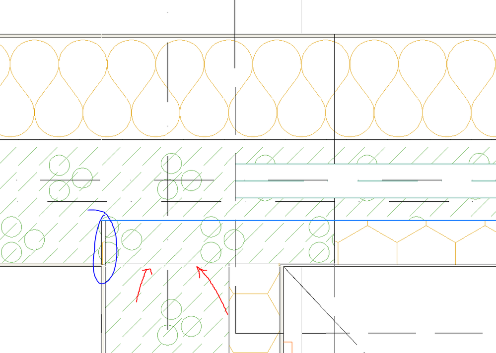

There's a problem with intersecting 3 walls. I'd like to know how to get rid of insulation fill I marked blue and why walls' cores won't merge (marked red). I did some changes in intersection priority (very low value for insulation and very high for wall) but it doesn't seem to work

It is hard to tell exactly what your trying to do. Something like this?
I don't have your exact fills but if you want to use the Attributes Manager you can put them in a .zip file and add them to your post as an attachment. ?
