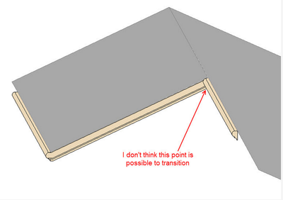

Can I use the same complex profile for a roof eave and rake? I want it to look the same with the detailed fascia and soffit wrapping and joining at the peak. I pretty sure I can do the eave with the fascia perpendicular to the roof plain. But it is not clear how to get it to wrap the corner and follow up the slope. I know that I can thicken the roof and set the ends, but I want to add detail to the profile. Is there a video for this? Can it be done? I am still new to AC. Thanks

I am assuming that by using the outside edge of the profile, then offsetting it, solves the kinked connection issue as it now has the offset edge to work with before it reaches the corner? Though this only works when you have exterior corners as interior corners have the opposite kink which is made worse by the offset.
Rather than using a Direct Connection with a Subtraction, you can use a Gooseneck with a Sloped Railing: Horizontal set to your Profile width. With one setting, you get all of your corners. Using a direct connection, you need a left side Subtraction when going from horizontal to sloped, and a right side Subtraction when going from sloped to horizontal.
I have been unable to get a tangential eave to work with an offset, so as far as I can tell, an offset is only required for a vertical eave.
The direction of the profile (which side of the origin it is on) will determine which direction you have to draw the railing (I think - I am still testing all of this).
The direction of the profile depends on how it is drawn relative to it's origin. ie. If it is drawn with the outside edge facing the right side, then you draw the railing anti-clockwise and vice versa.
Yes, this allows for the transition path to be calculated along the outside of the profile where you will have a greater than zero length for each section.
When you mitre these back to the roof corner, all the transitions will take place at the one node, so section length will be zero, which is why it doesn't work.
I haven't worked internal corners out yet.
All in the same plane is fine, it is when they go from raking back to horizontal again it just doesn't work.
I don't think it is actually possible as the flat transition needs to be on the back (wrong side) of the horizontal moulding.
If you figure it out, let me know.

Yeah... That is probably why you generally do not do your bargeboard with the same profile as your fascia.
In regards to this, in Edit Mode you could select all of your bargeboards and change their profile to a different one, either completely different or stretched to match the angle change.

So, it would appear that railing segmentation depends on how you draw your railing. If you use the auto associative pathing you will get a single segment for the railing between your two selected nodes regardless of how many actual nodes there were between your two. So when using it make sure you do not just auto path the entire roof, but at a minimum, add path nodes at locations where you have a transition between say a facia board and a bargeboard. If you do not do this you will be unable to select the relevant segment to change it's rotation / profile.
