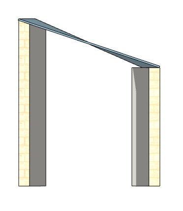

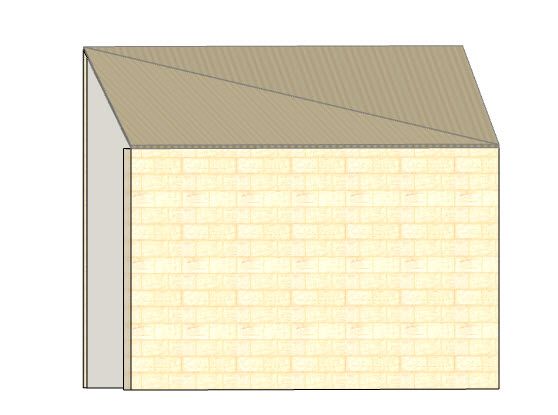

A twisted shell is probably the best way to explain it. I'm thinking that we can use straight rafters (16" o.c.) since we would know the high point, low point, and length that each member would need to be.
From there we should be able to add the roof sheathing with a slight bend to it. It's nothing dramatic, and I don't think it would be more difficult than a curved roof eave or eyebrow roof I seem to see a lot of. The bend we would have is more gentle than that, but it does basically extend through the entire roof.
Here are a couple of quick sketch models:
Steve Jepson
Very good! Yes, the twisted shell roof is perfect for that roof shape.

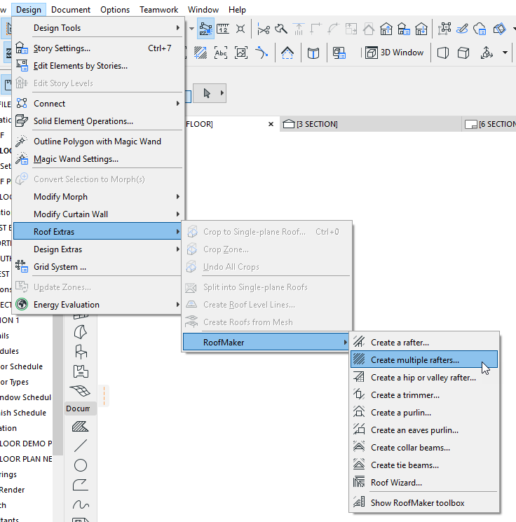

Tip: use a similar but flat plane roof to automatically generate the rafters with Roof Maker, then delete that roof and adjust the rafters individually to fit the curve of the twisted shell.
I am not sure it is worth using the twisted shell because it may not be detectable from the street anyway. You could let the plate line of the angled wall follow the slope of a regular smooth plage roof. ?
