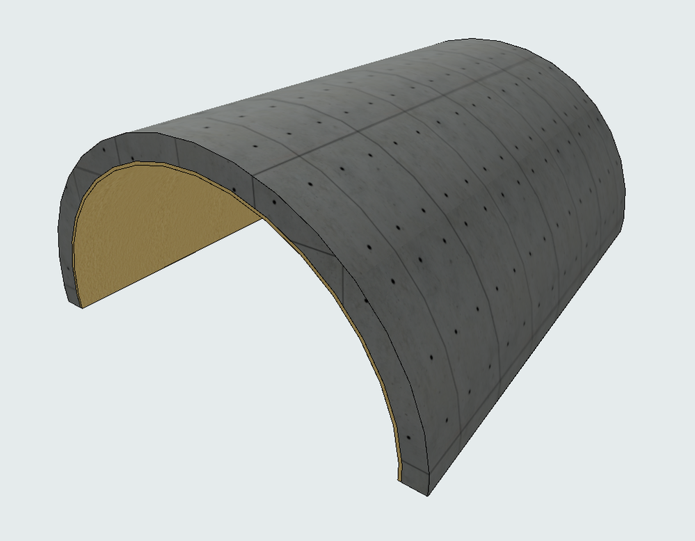

Hi there. I had trouble making Shell curves smoother. I've seen the similar topic before but the shell construction method is not the same so I want to ask again.
I am making a small church project with one tiny nave:

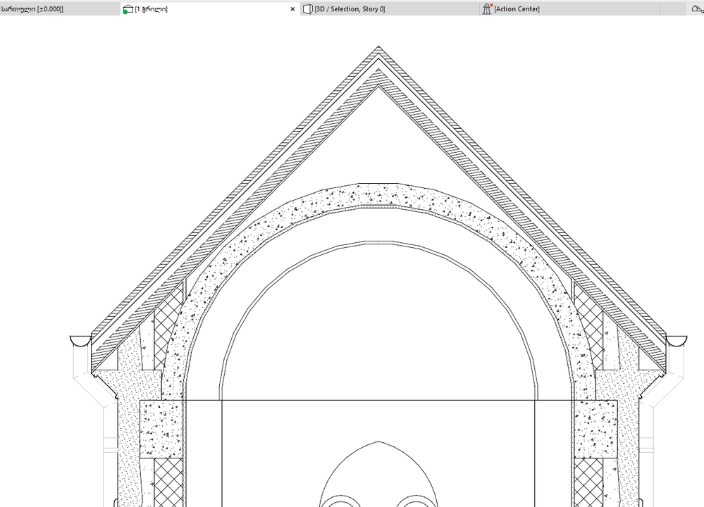

I am using Geometry Method: Extruded but the thing is I want the shell to have more segments so it will look smoother in the section. Now this is how it looks like:
P.S I want to know if there's a solution of this issue using particularly shells (not other methods like morph etc.).

the shell segmentation is calculated by the 3D engine , and can't be adjusted,
1 solution to this is to create the shell using magic wand, and set it's settings to create a a curve based on small segments.

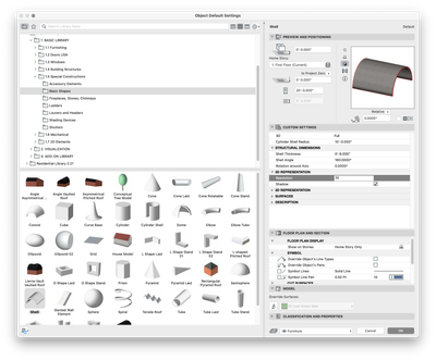

If the shape is shown correctly in your 3D image, then you could use the Shell Object rather than the Shell Tool. The Shell Objet has a parameter for resolution, so you can increase it as desired. You may need 2 Objects: one for the concrete and a second for the interior finish.
