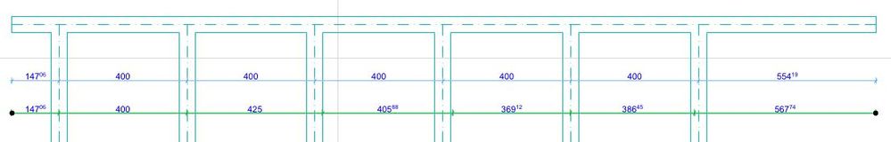

The upper row is dimensioned with the pet pallet the lower with cmd-cll both by clicking at the centre line perpendicular junction.
This screenshot will be a good point to start for the Graphisoft guy in tracking down what this issue is about.

Laszlo, I'm not sure if this was worth a new thread for the linear dimensioning issue.
If as previous I anchor the end points for my dimension line and cmd-clk to add in-between dimension points I am prone to get random static dimensions. If however I highlight the dimension line and then click again to bring up the pet pallet and select insert/merge dimension point then the cursor momentarily changes to a hammer before converting to a tick when the dimension point is reached. The resulting dimension is consistently accurate and normally as expected associative.
Both processes have been tested at the same zoom e.g. my normal working zoom.
To me this is starting to look like a bug in the dimensioning process.
Obviously the latter workflow is also a lot slower than just cmd-clk on a string of points...
I am testing this out now. I believe there is an accuracy issue when zoomed out beyond a certain point, which may or may not be reasonable. But I am still pinning down the details and I do tend to lean in favor of your findings at this point. As soon as I have the finer details of the matter sorted out I will post it to HQ.
