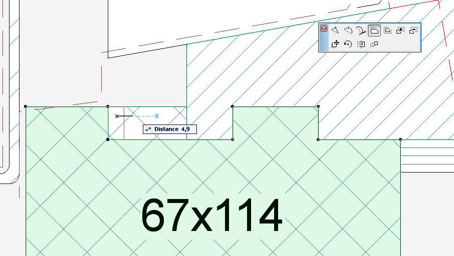

I'm also having issues with edge offset of fills, slabs, roofs etc picking a random point away from the edge (which shouldn't even be possible). I've reported these to the dutch reseller (Kubus). It's hard to reproduce, but it happens multiple times a day.
I've been working on 2d details a lot lately. So lots of work with fills and lots of dimensioning, it becomes very obvious. I'm no novice user, I've been drafting with ArchiCAD for almost 10 years. These problems are very recent. I'd say latest update, but I'm not 100% certain of that.

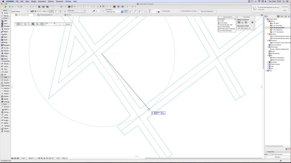

I don't know how to do a video but I have attached a screen grab showing the sort of results that occur when drawing a line between beams. The snap point has no relevance to what I want to draw, it is I think a perpendicular offset to the beam at the top. Just moving the end of the line around generates all sorts of unexpected and potentially random snap points when all I really want is a perpendicular connection. I'm not saying the guides don't work, just that they are counter intuitive and if you aren't zoomed in closely then the snapped point may be off from what is really wanted.
As I said previously I think the snap guides are trying to be too clever!

Below is a screenshot I sent to the local reseller.
A Snap References Point is created automatically after your cursor finds any node and stays over it for a little time, normally 1 second.
This amount of time can be specified by you in the "Highlight as Snap Reference after" field of the Work Environment Dialog's Input Constraints and Guides page.
If you set it to a large enough value, like 10 seconds or 20 seconds, then Snap Reference Points will practically never appear since you almost never leave your cursor above an element node that long.
You can use this trick along with the Q key on your keyboard, which will actually force a Snap Reference Point (or Line) to appear immediately.
Using these two things you can very well control when and where Snap Reference Points and Lines do and do not appear.
Erwin,
That indeed looks like something curious is going on.
Would you mind trying to experiment with the 2D Advanced Redraw options in your Work Environment Dialog to see if any other settings makes a difference in this.
You may also try to update your graphics card driver just to makes sure it is not a phenomenon caused by a driver issue.

I think this perhaps offers the best indication of a problem...
https://www.youtube.com/watch?v=knMw7CLh7a4&index=16&list=PLnXY6vLUwlWXj_1QX5iXbZ0cfscL-VNEX
What I don't think is considered by GS in the real world is that where you have a complex drawing then the resulting intersections aren't always what is anticipated. Where previously I might have expected a simple perpendicular connection the snap guides are offering numerous intersections some of which can be misinterpreted.
I guess I can turn the guides off unless really needed. However I am still getting odd results for the dimensioning mentioned previously. If I dimension by clicking the edge or centreline of the beams I get the right result, however, if I click on the intersection points of two beams the resulting dimension can be random. It is also necessary for a beam to be highlighted before a dimension becomes associated which slows things down.

I've tried to show the dutch reseller Kubus today with TeamViewer when the bug occured again, sadly that cancelled the offset, so I couldn't show it again. They did inform me that Graphisoft has already been told about this, so no need to report this edge offset thing a second time, Laszlo.
I've also updated the drivers for our Quadro K2000, as you suggested (good idea, actually!), that didn't work.
