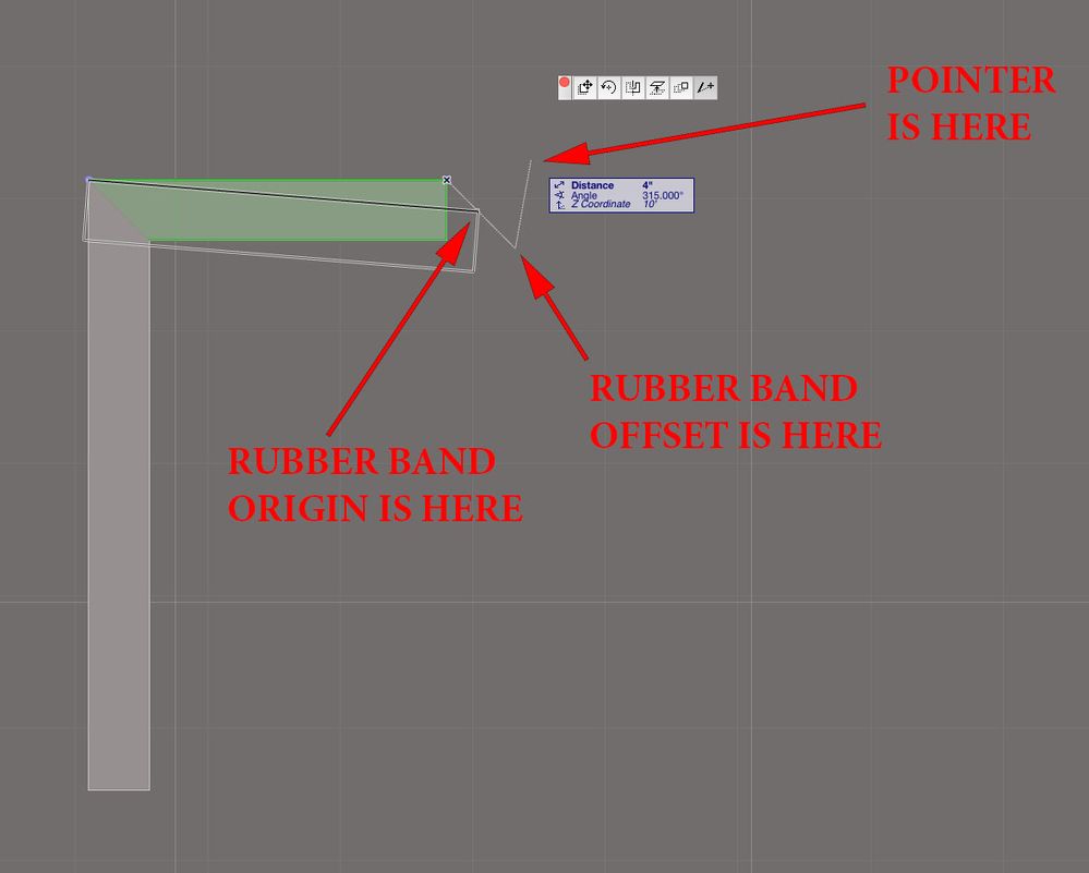

Sorry being lazy I haven't read the four pages of previous posts but it sounds like from what I have read this is the same glitch we are having with Dimension and Label tools and any kind of polyline type tool eg. Wall, Line, slab, mesh or roof tools
I made a movie showing examples below
Wall tool
Dimension tool

I found that it only happens to me when having a fill below my workspace, so that when performing tasks over the fill the anomaly occurs but when I turn the fill off, it goes away.

lasse
and here.....
