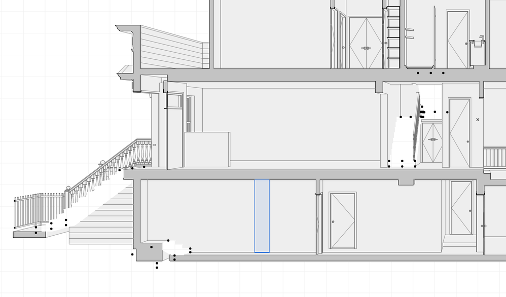

Greetings, I am having a similar issue in AC25 V 4013 using Mac OS 10.15.7.  I have tried the settings noted in the solution posted above however it is not working.  Basically the stair can be selected in section but is not visible.  Please see the attached screenshots.
AC27 v. 4060 w/ MEP, Cadimage, Twinmotion 2023.2.2 using AC from AC6.0, 2021 MacPro M1 chip, Adobe CC. Used AC on both platforms.
In the Model View Options Dialog, go to the "Stair Options" panel and make sure the "Stair 3D and Section/Elevation" options is set to "Full".
Also, remember that your Views are using these MVO settings so you need to check and change all your MVO combinations in which you want the Stair to be shown.
It seems that somehow the stair can have a different renovation filter setting compared to the components of the stair.
https://community.graphisoft.com/t5/Document-Visualize-forum/AC25-stair-shows-in-3D-window-but-not-i...
When they are all set back the same, all is good again.
Maybe when Yvonne was playing with the settings, it reset the renovation filters as well - if that was the same issue?
