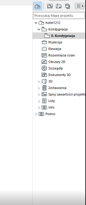

Hi all,
When launching Archicad storeys show up normally for a few seconds, but when Archicad fully open the storeys disappear,
Storeys are shown up correctly when launching
and after few seconds they disappear
I was looking for this problem on the forum and I couldn't find a solution for it.
1 REPLY 1
As Archicad is opening and the palettes are generating, they may well be the default settings (I have never really paid much attention).
But once the file is open fully and the palettes have moved to the correct positions, they will show the content for what ever you have saved in the file you have opened.
It seems the file you have opened only has one storey, so that is all you are seeing.
Open another (maybe the default template) and see if it is the same.
If it is, then add a storey, save and close the file.
Then open that file again.
If there is only one storey, then I would be getting in touch with your local support for help, as that should not be happening.
