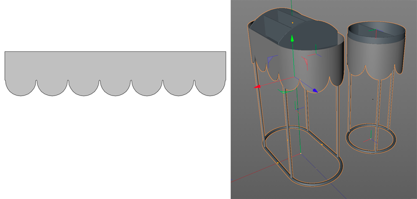

I have drawn a more complicated object which I want to stretch along the X Axis only, so that the profile distorts - please see the attached image.
Specifically, what I'm trying to do is elevate a section that looks like the attached model (which was done in Cinema 4D), so that the profile will distort more as it runs along the radiussed edge towards the corner of the table top.

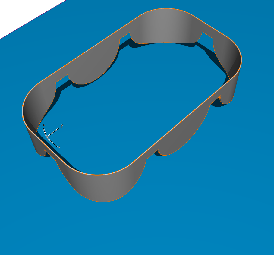

Are we talking about something like this?
It is doable.

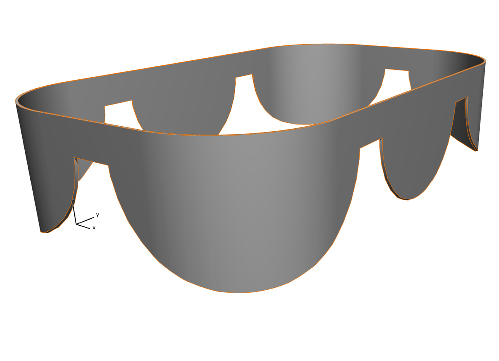

another shot.

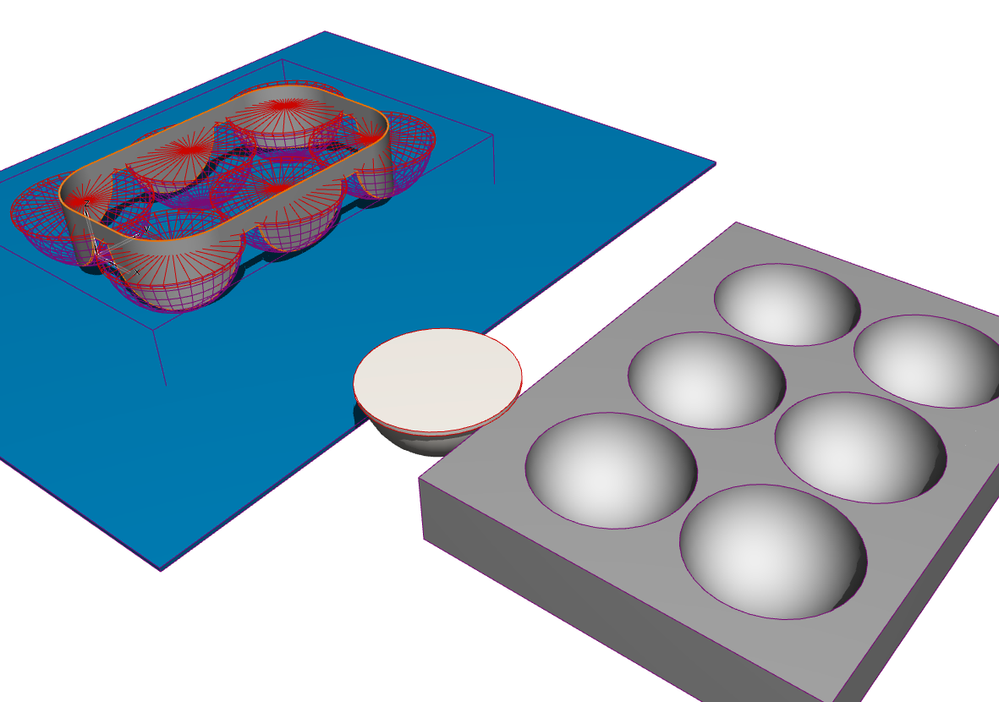

Basically I created an "egg crate" using shells for the sections, a slab for the block and converted to a Morph so I could subtracted it from the walls.
Therefore the corner is a result of the shell.
