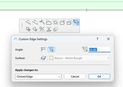

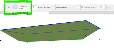

You can't taper a slab, at best you can set its edge angles to be other than 90 degrees but that will edit all edges:
To model that you can either make a custom profile and extrude it or model it with the morph tool.
Lingwisyer
Guru

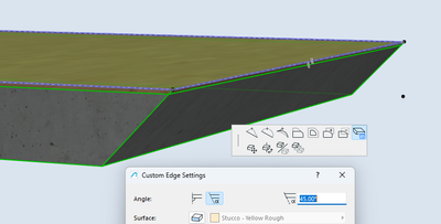

You can set them individually by going through the Custom Edge Settings.
Do note that in both cases, the rotation is from the top edge regardless of your reference point, and is not represented in the Floor Plan
