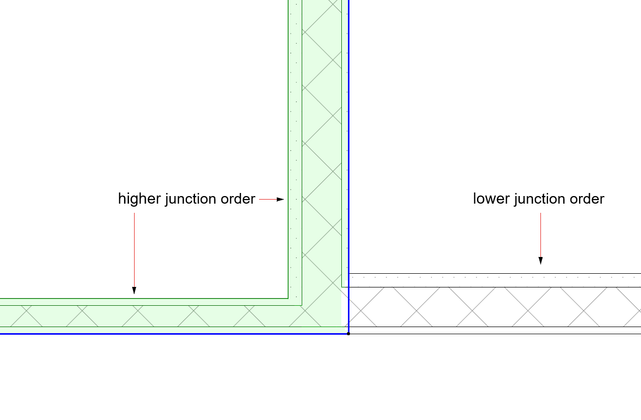

have you tried different junction orders for the walls?
https://help.graphisoft.com/AC/28/int/_AC28_Help/040_ElementsVB/040_ElementsVB-272.htm#XREF_41668_Wa...
for example like this

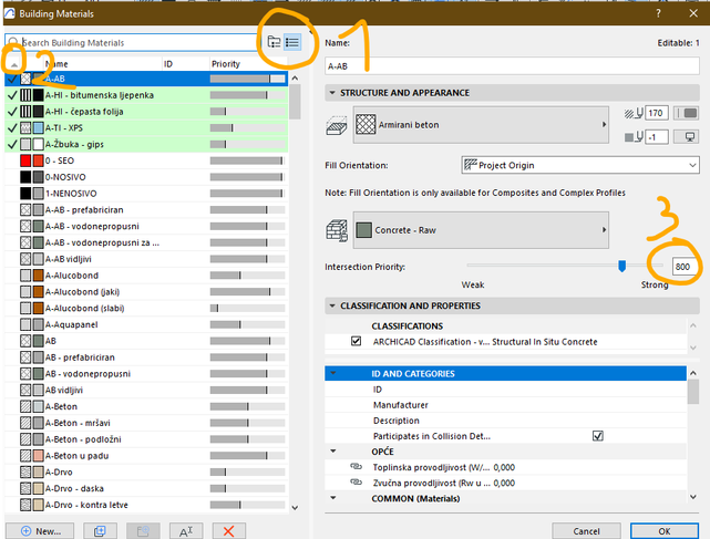

Check to see whether your wall core has the highest building material intersection priority number. The easiest way to do this is to select all the walls that you need in the intersection (all three of them) and then go to Options -> Element Attributes -> Building Materials. Then, disable the folder view and after that sort by "check mark" and all your used Building Materials should be on top and highlighted. Now, check their intersection priorities and try to fiddle with them.
Be wary. The actions you do here can have unforeseen consequences on other parts of the model, so be sure to take notes of default intersection priorities if you mess something up.
Good luck and let us now if it's fixed.
