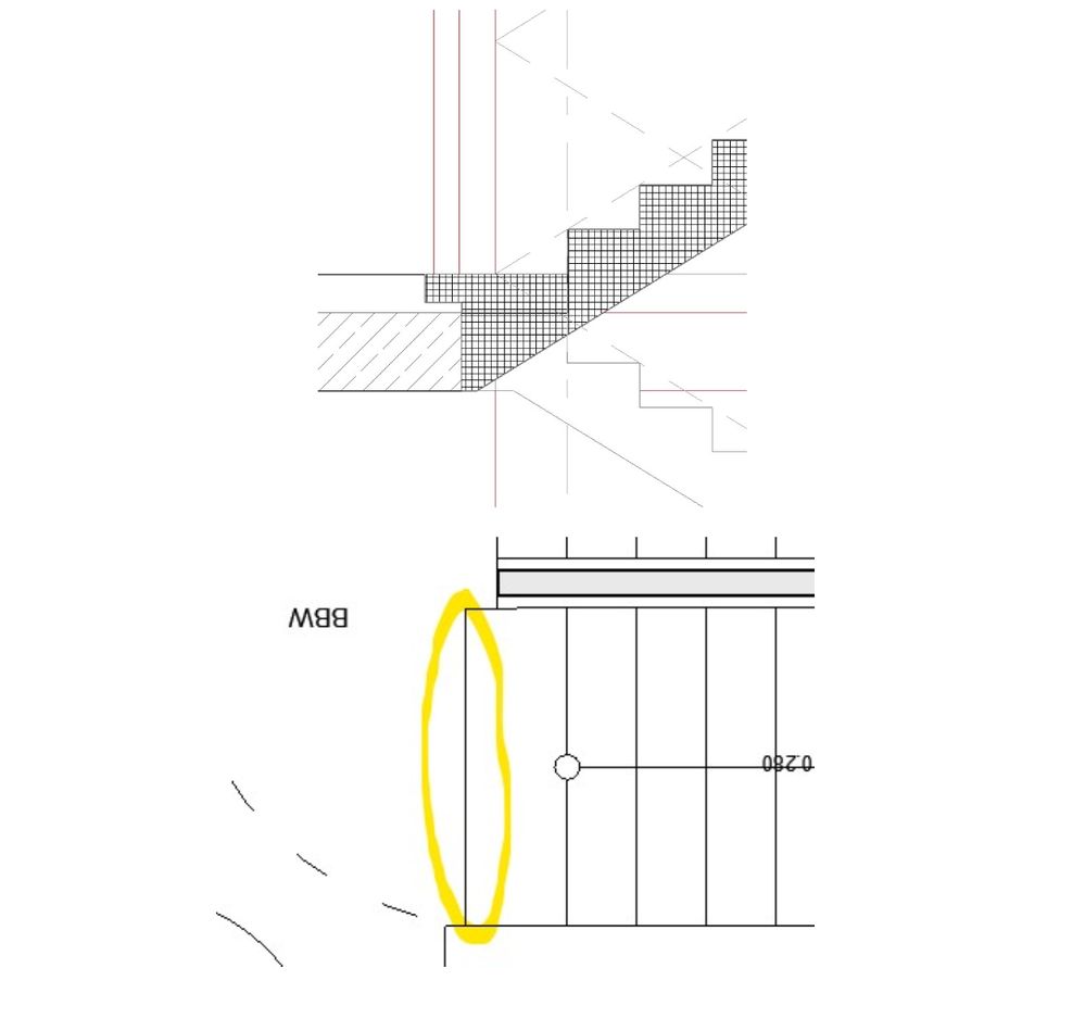

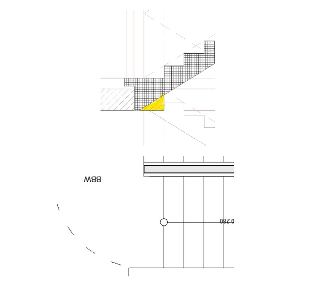

Hi there,
I'm having a problem ensuring that my stair, moreover its connection with a floor slab, is correct in both plan and section/3d.
When I stretch the slab to the touch first step, it looks correct in plan, however in section you get this ugly cut through with an overlap (highlighted in yellow):
 When I stretch the slab so that it works fine in 3d/section, it creates this new line that I don't want to show up in the plan (encircled in yellow):

Miha_M
Try to experiment with basic stair options and change between "start with tread" vs. "start with riser". Then go to Flight Structure Settings and set the parameters for Flight-Start so the stair fits the slab and floor finish hight. It does work, but needs some tweaking. It helps if you have a section through stairs, so you can measure some needed dimensions.
| Archicad 4.55 - 27
| HP Z840 | 2× E5-2643 v4 | 64 GB RAM | Quadro M5000 | Windows 10 Pro x64
| HP Z4 G4 | W-2245 | 64 GB RAM | RTX A4000 | Windows 11
You could also create a secondary slab or roof piece matching the angle of the stairs to solid elements subtract downwards and then hide the piece doing the SEO
This is assuming the stairs have to be the way you have them drawn otherwise @Miha_M s reply is the best way to go
Lingwisyer
Guru
If you go into Edit mode for the tread you can turn off the leading edge, though I do not recall you being able to turn off the side edges so you will still have the extension there...
Ling.
Edit: actually, that is your slab... how is that bottom tread built? This is not with the inbuilt stair tool?
