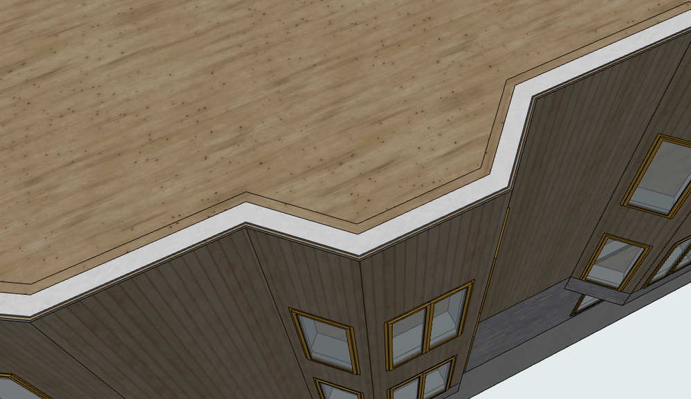

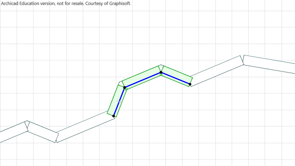

I am using Archicad 26 and recently I've faced the issue of my wall sections not visually connecting to eachother in the 2D plans (see image), but they are connected correctly,  and displayed so in 3D. I believe I've accidentally enabled a setting through a shortcut, but have been unable to find how to remedy this.
This only happens in Archicad for this one file, not any other. Any help is appreciated (:

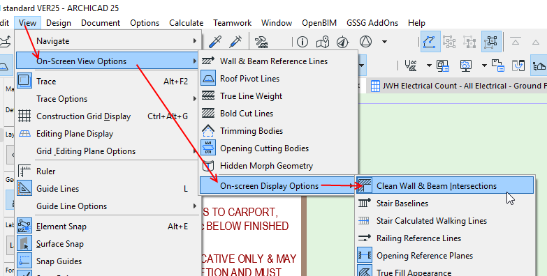

You have probably turned off 'Clean wall & Beam Intersections' which you can find in the 'On-Screen View Options'.
My menu structure may be different to the default, but it will be somewhere like this.
