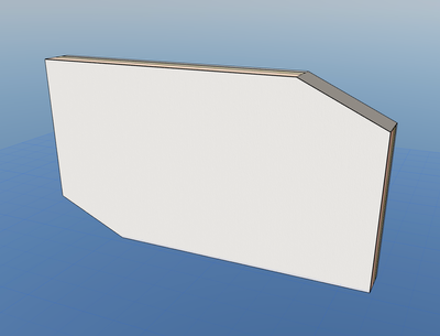

Doing it one after another should work:

There are at least 3 ways to trim a wall.
Connect > Trim to roof
Solid Element Operation
Crop to roof.
They should all work if done separately for each roof.
However the Connect > Trim to Roof will only work if the roof planes completely overlap the wall in plan.
That is because this method uses the roof cutting body, and any wall outside of that trimming body will be discarded.
3 weeks ago
And a fourth method is to add an opening to the wall.
These can be any shape, not just a flat cut like a roof.
