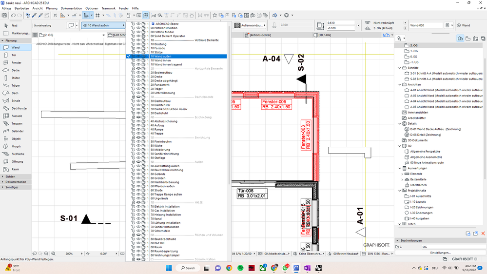

Hi eveyone!
My wall hatching from my previous save is showing but when I draw a new wall, it doenst show any hatching.
I check the model view settings and make sure the wall layer is turned on too, but the hatching is still not showing. Does anyone has a solution to this ?
Here is a screenshot of my view
Thank you in advance !

It could be that the walls are on different renovation filters or the wall not showing the hatch has a lower height so it doesn’t pass through the floor plan cut plane.

It's your wall height. As seen on your screenshot it is 61 centimeters, which is below your floor plan cut plane of most possibly 1 meter. So you are just seeing the outline.

ah yes! thank you so much!

yes i realised that now! thank you so much !!
