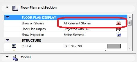

Hi folks!
I made a column in a intermediate level (see the attached pic #1), between two stories. However, the column isn't showed in a original level, only on the stories above (see the attached pic #2).
How is the correct way to adjust the definitions of "Floor Plan Cut Plane" and "Floor Plan & Section" to represents the column correctly? I tried to study this contents but i need help.

Are you sure that the column is on the Story 0?
Seems to be on Story 1 with the setting for "Show on Stories= Home & One Story Up".
I have no problems with my column that has elevation 200cm from the Story 0.

Actualy, that column i made with wall tool.
Both tools (wall and column) have the same problem in your representation.But, your help (using an object) resolves like a palliative. Later i will study this problems again.

I would have thought setting the wall to All Relevant Stories should fix your display issues.
