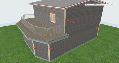

I am evaluating the trial license of Archicad 26. Very new to the program. So basic questions coming :). Tried forums and resources, but as of now cannot find my answers.
Two things that I cannot figure out:
1. How to change the window casing color? 
2. Why is the wall override surface not joining at the corners (picture)? I just created a new composite with 3 layers/skins and overridden the surface. Every time I draw walls that I created or use default walls and override the outside surface this happens.

Denissss
Thank you.
So obvious checkboxes and I just missed these searching around 😄
