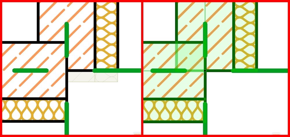

Walls don' t join at all
Hey. I have a problem will wall intersection. They connect only in the centre and the rest looks like in the picture. Althought it' s only visible when I select them. It' not the case of material because they are the same. I've tried everything to connect them. Please help me.

Try this:
1. Select both walls
2. Go Edit->Reshape->Intersect
3. Pan or zoom out a little to force refresh

Just checking you have got the "Clean Wall" button activated?

ejrolon wrote:
Try this:
I' ve tried and it stays the same.
I can't find such button.
Eduardo Rolon
Under the View Menu -> On Screen View Options -> Clean Wall Intersections
Presuming that both walls are in the same layer…

Ok, I know what was wrong. I had to switch it on.
