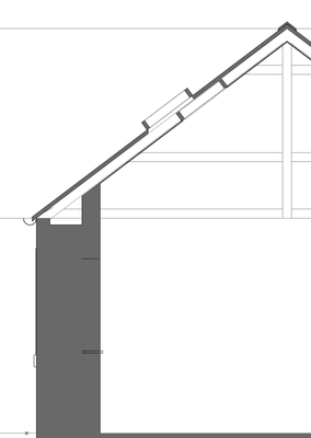

Walls not appearing on 3d view
I have created a set of internal walls at ground floor level to show 'new' internal linings onto an existing granite external wall. I have trimmed these to a plasterboard ceiling,  and both walls and ceilings are appearing on section, however only the ceiling appears in 3d views. The walls between eaves level and ceiling are appearing 'hidden'.

thanks to both, I found a tool called 'clear all connections' which seemed to do the trick.

Your 3D view may be using different layers or renovation filters compared to the plans and section.
If that is not it then check for duplicate or overlapping elements that may be trimming each other away in 3D.
Rubia Torres
In addition to Barry's comment, if you have overlapping elements in different layers, you may use different intersection numbers to avoid such issue.
