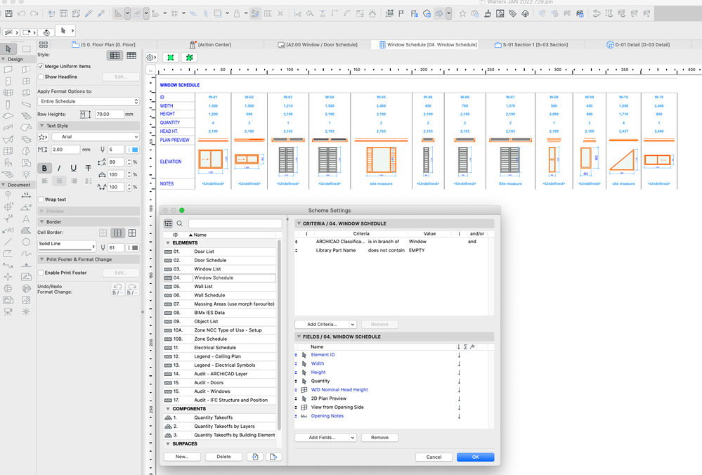

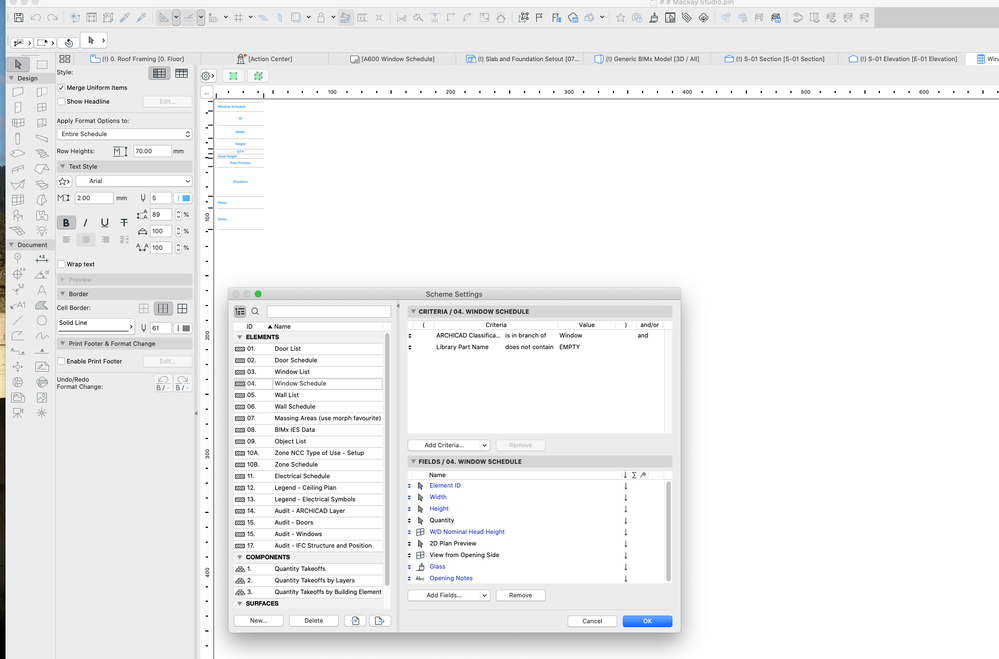

Are your Windows classified as Windows?
Your Schedule Criteria says:
"Archicad Classification" is in branch of "Window"
which means that your Windows must be classified as Windows to appear on the Schedule.
Solution
Hi Laszlo. Yes that worked. I switched from V20 to V24 last year so
hadn't encountered this change before. My other job where it was working was an earlier V20 brought into V24. Thank you.

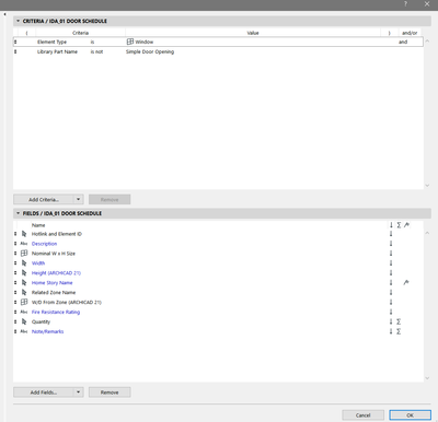

ryejuan
check your scheme settings if you are choosing the correct element type.

Here are two different projects showing schema settings and where one shows the elements and the other no ID views etc. Hope this may help
Screen Shot 2022-01-12 at 6.19.36 pm.pngScreen Shot 2022-01-12 at 6.22.35 pm.png
But are the widows categorized or just undefined? When mine are undefined they don't populate in the schedule

in my opinion simplest way of setting up the window schedule

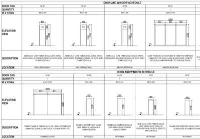

My objective is to create a wall and door schedule that I can see the I.D views of the windows or doors quantity, head heights etc

i haven't tried merging the wall and door & window in one scheme though. but if you are referring to something like this?

They are not in one scheme. The tow schedules are just placed on one sheet a they both fit.  I still can't work out what is wrong but.
