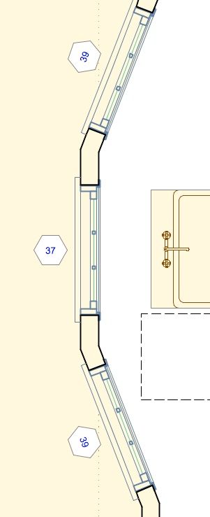

I am trying to use labels to tag my windows rather then than the marker option that is available within the window settings. I am doing this because I can't seem to get marker to show up as a hexagon, and it seems to work nicely for tagging in elevations. I have one particurley pesky label that does not want to rotate to be in line with the other tags. Whenever I try to rotate the label to match the others it defaults to being upside down or reading from the right as I have shown in the two images. Does anyone have any ideas? Thanks in advance!

It would seem the window markers are even more infuriating then the window labels. All I want is to get all of the tags to sit like #37 around this bay window, in a horizontal fashion. Anyone know of any good work arounds?
Thanks!
Thanks!
-Chris
You will have to modify the Library Part used by the Marker or Label.
There is a GDL Global variable that returns the angle between the Wall of the Window and the horizontal direction. It is called WALL_DIRECTION:
http://www.archicadwiki.com/Global%20GDL%20Parameters#WALLDIRECTION
You will have to rotate the 2D of the GDL object to compensate for the inclination of the Wall the Window is placed into.
This is the theory, unfortunately I do not have time to test if it works.
