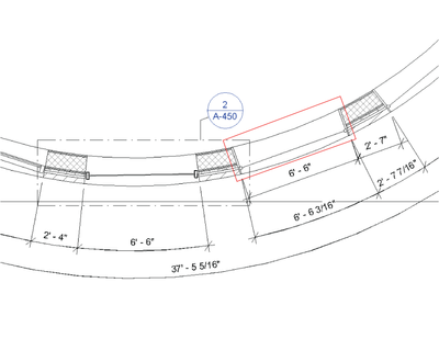

Hello,
The default behavior when placing windows in curved walls is making window jambs perpendicular to the wall baseline. You can see such situation in the left window in the screenshot below.
But I need to have jambs parallel to each other, like it's presented in the right window (marked red). Is it possible in Archicad?

Steve Jepson
I am not understanding the situation.  The window jambs will alwasys be paralell with each other, and you will always want them to be perpendicular to the wall opening right ?   The window will always be a rectangle in a curved wall.
Or are you wanting to make a curved window jambs and curved glass to match curve of the wall ?

I was sure some of the default doors and windows had that option, but it only seems to appear in the Window / Door Opening objects... The parameter IS there for all of them though... bParalellInCurvedWalls...
Mike96
No, Steve, no. It's exactly opposite to what you described. Both what I want and what Archicad behaves like. Take a standard window and place it in a curved wall. You won't get rectangular window opening, as you said. It will look like a bent beam - its sides will not be parallel to each other, which is what I need.
I'm not talking about special curved window object. I just want a window opening (with glass panes and frames) with parallel sides.
