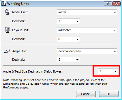

This is the field in Project Preferences (in Working Units as Erika said) that controls it.
See attached image.
i have inserted in box "Decimali Angolo e Dimensione Testo nei dialoghi" the number 3, but in the Zone Room, the decimanl number of "R.A.I." is 0,09... I thought it became 0,090.....
it looks under at the image to understand...
thanks for the attention and excuse me for possible errors of language
Fabio

Fabio:
I think the setting you are looking for is under Project Preferences > Dimensions > Zone units.
David
