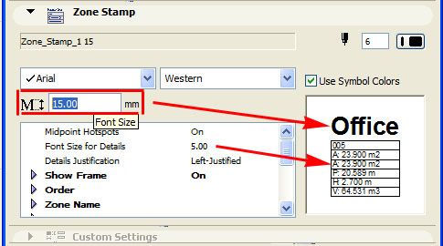

ZONE STAMP AND NAME SIZE

I can increase the font size of the details.

The zone name font size is adjusted in the box in the image.
The size of the actual stamp itself can depend on which zone stamp you are using. Most are controlled by the maximum length of either the zone name text or detail text, and will automatically resize when the scale of the drawing is changed, although a custom zone stamp could have manual control over the stamp size if it was coded that way; it's just a GDL object.

Thanks Peter!
I will give it try when I get to work tmrr.
