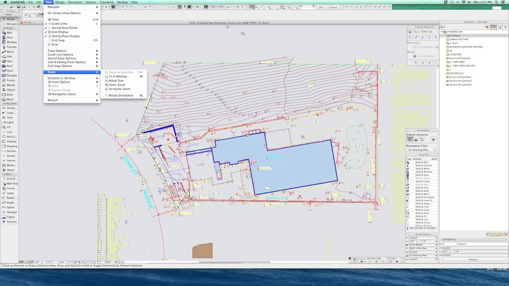

Zoom Selection ability greyed out....what gives?
they just installed AC17 and AC18 on my MAC.
I'm now getting "re" used to the MAC.....again...so for some reason...the "zoom selection" is now 'greyed out'?
Any advice?

Do you have anything selected?
Eduardo Rolon
Did you select something? It looks like you are only highlighting a couple of walls.

no....I don't want to "select" anything....I want to "zoom" to a windowed area? do I need to select something...then use the zoom? I don't recall it working like that....but I'll try it.

OK..so I used the selection marquee..just tried it and still the "zoom to selected area" isn't working? I'm not going nuts here...I know the zoom to a selected area used to work.....what gives?

The grayed one is the one that says "Zoom to selection" so you need to have something selected.
"Zoom Window" is the magnifying glass with the plus sign at the bottom of the window. Click it and draw the rectangle.

thank you sir......my bad.
it was the end of the day....and I couldn't remember "which" DA@# icon zooms in and out......thanks.
