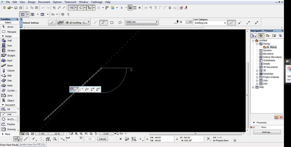

i think i am turning on guide lines from the first but this does not make the line straight without have to press shift the image is shown i am turning it on

Ahmed,
Karl just beat me to it as I was getting my post ready, but here goes anyway:
When turned on, guide lines will appear on screen that your cursor will snap to when close enough to them. You can customize it to only accept 90 degree increments. See image below and check the ArchiCAD Help file.
