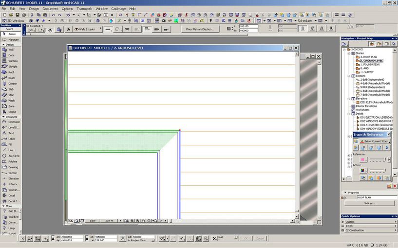

Hi
when 2 elements are on top of each other, ie slab and wall, if I pick the wall which it gets highlighted and the end grip dots appear, and then if I try to pick the end node to stretch it, my cursor or arrow end up picking the slab not the wall or even if I don't press the mouse button just hover my mouse over the wall grip point the slab gets highlighted indicating that if I press the mouse button the slab will get picked not the wall the only way around this problem is to press the wall tool button, then I can select the wall which is annoying which means every time I try to stretch move or modify an element it' tool icon has to be activated. This problem use to happen in 10, I thought upgrading to 11 will fix this problem but obviously not. new and reset all will fix this problem temporarily and it will start happening again after a short period of time.
