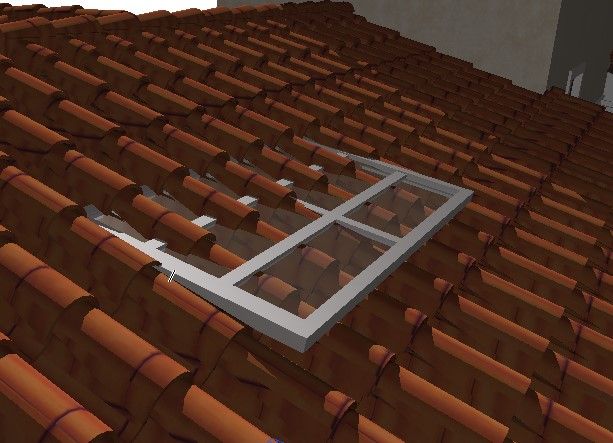

Did you script the skylight object?
If so you can add a PRISM that extend above and below the skylight and have it so it is only active when a Solid Element Operation is activated.
The PRISM itself will never show but it will cut what ever it passes through.
if GLOB_CONTEXT > 40 and GLOB_CONTEXT < 50 then
PRISM_ ......
endif
Otherwise if it is a standard skylight and you placed it with the skylight tool, it will cut a hole in the roof and if those tiles are a roof accessory, it should cut those as well (I can't say I have tried it though - I never model roof tiles).

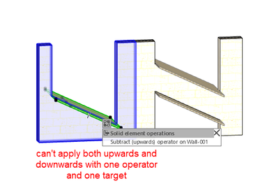

I am still not sure what @Alexandre dias is exactly trying to do.
With only one target and one operator, you can only apply either subtraction with upward or downward extrusion only.
You can't apply both.
You need two operators to do that.

Alexandre dias
Hi, Thanks a lot for each answer I got and sorry it took so long to come back to you guys. What I'm trying to do is to cut the roof, both roof tiles and wood framing in an area I previewed a skylight. Image attached. Thanks again.
