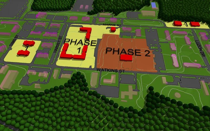

You can apply a material to the top of the mesh that shows the roads/driveways/paths etc, similar to the one attached. This is relatively simple to create using fills and making a texture from the 3D window. If there is enough interest I can create a tutorial on how to do it.
Another way is to actually model the elements with a mesh, by copying the existing mesh and minusing the paths out of it, then pasting the existing mesh and minusing the rest out of it. This has been covered on ArchiCAD-Talk a few times, but can have unpredictable results depending on the complexity of your mesh. However it does allow you to raise/lower the paths.

hey link with your first method can you run paths up hills? like the hill in my attatchment?
if so, a tutorial would be sweet
Done.
Please check it out at http://archicad-talk.graphisoft.com/viewtopic.php?t=2599&postdays=0&postorder=asc&start=0
