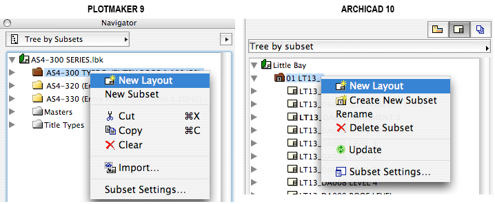

You cannot copy-paste layouts or subsets in AC10 - right-click menu item is gone and
Seriously .. is this a joke?
It ain't funny

On a PC we can just hold down ctrl while we drag the drawing/layout/subset in the Navigator. Just hold down the mac equivalent (opt/apple?) and it should work for you too.
Now if we could only find a way to clone subsets......

Oh thats great .. I never knew you could do that
Problem solved.
Although I still wonder why they removed the copy/duplicate menu items although the ability to do it is still there .. Copy/Paste is a basic menu item that should be available for anything that can be copied.

I think you can also select a drawing in a layout and right click (or cntrl/comand c) and copy the drawing. You can then go to another layout and paste. I don't know why the functionality was changed. Thanks for the cntrl/command drag trick....

why? well can anyone think of a good reason to remove the ability to Cmd/Ctrl-C an item which can be copied, but keep an obscure, obviously not widely known method of doing the same thing? Strange logic indeed ..
Anyway .. thanks for another great tip Link. It is Opt on the Mac, not Cmd btw. Is this function documented anywhere? i wonder where else it works
